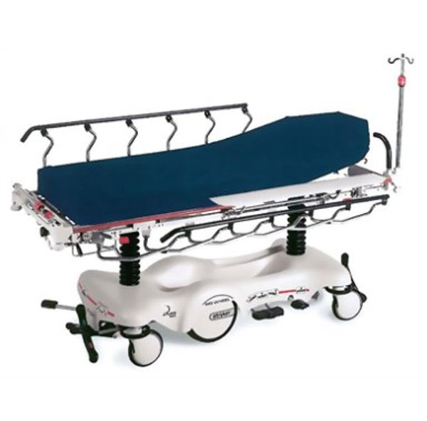

What type of oil can I use in the manual pump-up Stryker patient beds. The red colored oil Stryker sells is way expensive, want to try other type.
   RE: Stretcher Report Post
Wed Mar 07 2018Reply from Ray Brown, CBET
Right out of the 1001 book.. Mobil Aero HFA hydraulic fluid.
