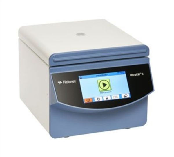

resetiing error codes
WHAT COMBINATION OF KEYS TO USE TO RESET ERROR CODES ON HELMER CELLWASHER. PLEASE HELP

To reset most error messages on a Helmer Ultra CW you need to:
Open the lid and power the unit off. After approximatley 10 seceonds (for error codes 04,06-09, 21-26) turn the unit back on.
For error codes 60 and higher you need to wait for approximatley one minute before turning on.
