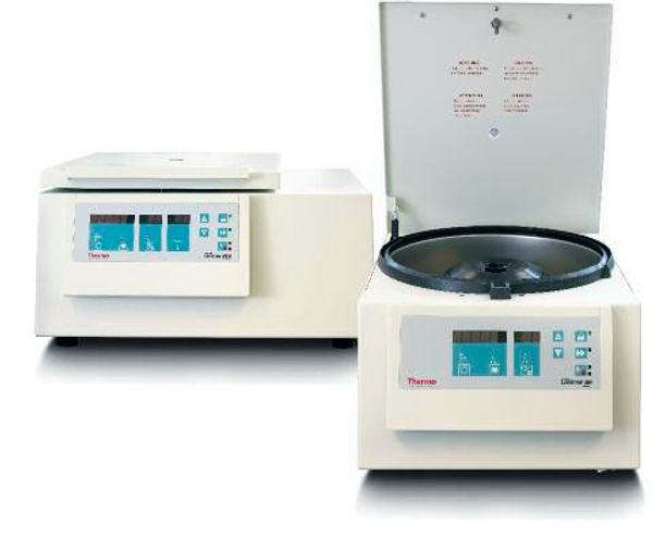

Labofuge 400 "OPEN" displayed
Display is showing OPEN on display with the lid latched. I have ruled out the latch/Micro switches by swapping it out. I pulled the XA connector and jumped the two pins. I seem to remember something about a zener diode for the 15v supply. Does anyone have any more detailed information? My next call will be to the folks at Ozark.
