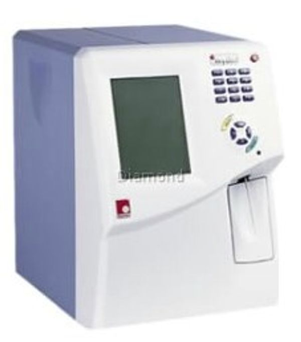

Printer instalation
Orrphy mathy 18 printer install
   RE: Hematology Analyzer Report Post
Mon Jan 31 2022Reply from Gile
On Mythic18/22 standard printer is SEIKO DPU414 and EPSON LX300 for this model driver is installed in instrument, only select printer in setup menu
For laser printer compatibile model is HPLJ2035, HPLJ2055, HPLJ M203 etc... but for this printer you have install USB driver PCL3 or PCL6 on instrument
