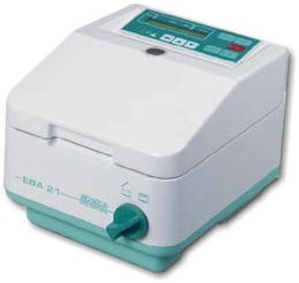

Device will open during centrifugation.
   RE: Centrifuge Report Post
Fri Aug 24 2018Reply from codeman30
Does anyone know why this is???
Fri Aug 24 2018Reply from Hettich Tech Service - USA
Hello, If you can open the EBA 21 during centrifugation, you'll need to replace the lid lock assembly. Depending on whether it is 120v or 220v centrifuge, it will have a different part number. Please contact service@hettweb.com with your TYP number and Werknmr (model number and serial number) so we can help! Thanks! Hettich Instruments Service
