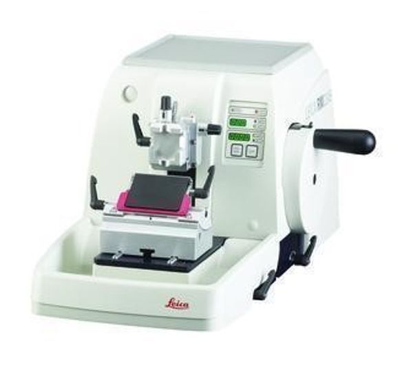

hi anyone know ,how we should clear service counter in RM2145 and RM2245 ? regards
   RE: Microtome Report Post
Mon Mar 09 2020Reply from umitedi
Turn off power. Press menu key. You don't free finder. You will see counter number. Turn on power. Change key. Near key clear. You will see number zero. Turn off power again. Turn on. OK
Wed Mar 11 2020Reply from Ross
What does "You don't free finder" mean?
Ross
Thu Mar 12 2020Reply from umitedi
Take your hand off. Remove your hand from the key. Press the end key. Meaning this
Thu Mar 12 2020Reply from davood_la
dear umitedi
thank you for your answer but that is work just in the RM2245 or RM2255 not in the RM2145 or RM2155 as you know RM 21xx has Different and small panel ....
Thu Mar 12 2020Reply from Ross
This is the forum for the 2245.
