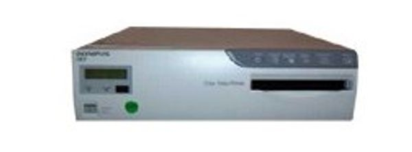

Hi, Does anyone have information on the Olympus flushing pump. I have one that is not delivering enough fluid. No kinks or leaks or blockages.

Can you verify the exact flushing pump model you have?   The OEP series posted here is for a printer.   The pump should be OPF series.   The flushing pump head assembly has a finite life, typcially 2 to 5 years.   There's a performce test you can run to verify output and determine if the pump head is worn or not. The good news is that the pump head is a replacable assembly and can be done quite easily in the field without tools.  I have instructions for both the output test and the head replacmeent, but I would need the model number your have to verify if its applicable before sedning it to the MedWrench Admin for posting.   -  Cipher
