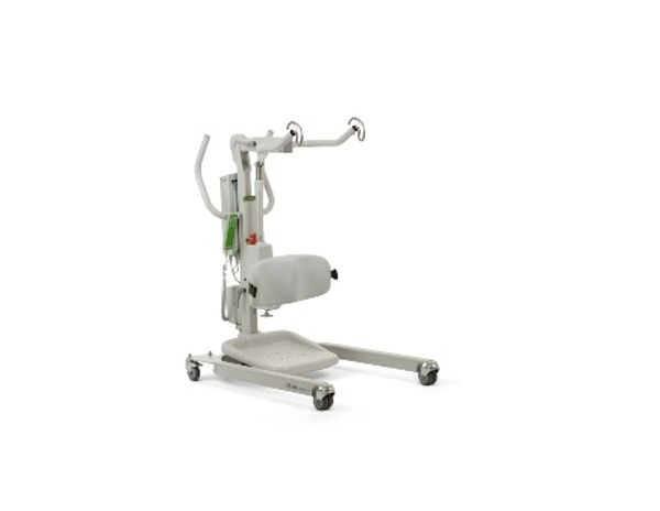

Lift not working
Lift motor not responding.
   RE: Lift-Patient Transfer Report Post
Thu May 13 2021Reply from Chris S
Chris S
1. Check that the emergency stop has not been engaged.
2. Make sure that the cables to the control box are connected correctly.
3. Make sure that the charging cable is not connected to a socket.
4. Check the battery voltage.
5. Check that the battery’s contact plates are not defective or broken.
6. If the lift still does not work properly, please contact Hill-Rom.
