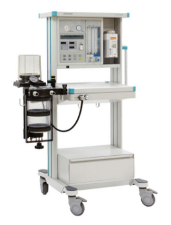

we encounter a High tidal volume-difference of 100ml from measured and Gauge on bellows-set at 30-and a higher reading at 40 does anyone provide us with a service manual as well-thanks

Check the APL valve Expiratory valve (In the waste air from the patient, it sticks when there is moisture.)
Try replace the respiratory system with another device,
