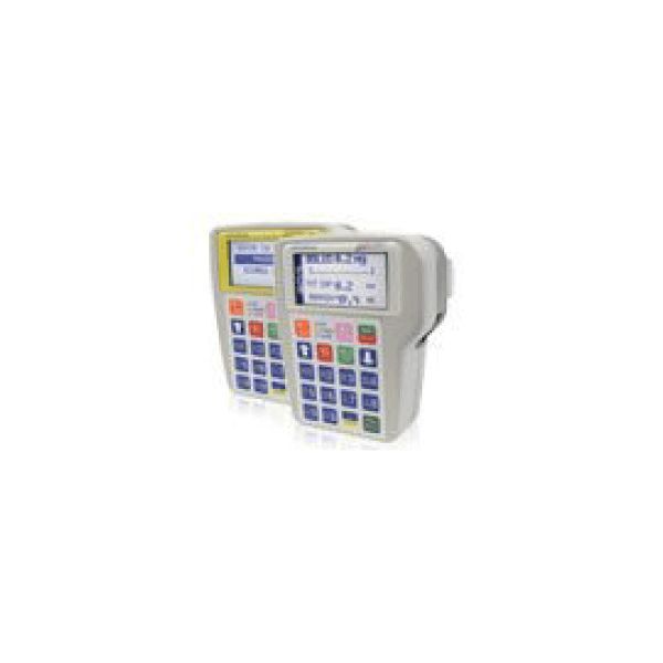

How do I find the access code to change rate?

We have 2 ways to change the infusion rate:
Wait for the pump to complete the boost upcycle
Some pumps may have lock level, either 5 or 9 digit lock code. xxxx-94629, 94629.
For current therapy:
Highlight "Program" and hit "Yes/ Enter".
Highlight ""Resume" and "Yes/ Enter"
Hit "No/ to Review" 4 times to accept the setting. Keep hitting "Yes" 2 more times until the cursor highlighted "Rate"
Enter the design rate, then hit "Yes/ Enter" to accept the setting.
Hit "Run".
For new therapy:
Highlight "Program", hit "Enter".
Move the cursor to highlight "New Program", then "Enter".
Choose the route " Continuous, PCA..."
Enter bag volume, Amt TBI, rate....
Hit Run when done.
Hope it helps!
