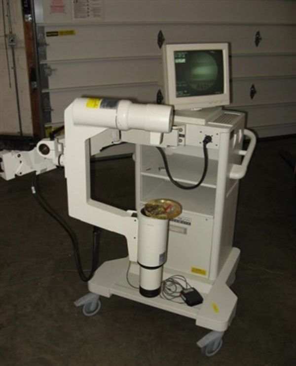

The c arm makes a loud constant beep. Does anyone have a service manual

Depending on the software version and computer model in that system, I would say that the internal computer UPS has gone bad. These computers are end of life.

on your Hologic Fluoroscan Mini C-Arm it sounds like power supply is bad
