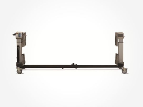

Hello Does anyone have the Preventative Maintenance Checklist? Thanks in advance.
Thu Dec 23 2021Reply from Priebe
Surgical bases covered:
5803 Advance Control I-base, Retractable
Tools Required:
Digital Multi-meter with probe and hook leads.
Torque Wrench, calibrated at +/- three percent 95 foot/pounds (Sears Craftsman Digitork model 44597 or
equivalent [equiv]).
OSI Rotation Test Bar
Digital Level
Force Gauge, to 50lbs
Hex keys, (Allen), ball head, minimum handle length 4 inch (in): 5/64 in, 5/32 in, 3/16 in, 5/16 in.
Materials Required:
5803 Advance Control Base Owners Manual – NW0646 Rev A
Pass Fail
1. General Overall Condition.
1.1 ( ) ( ) Table base is clean, without signs of hazardous contamination, is consistent with proper care.

3. All Casters Operate Properly.
3.1 ( ) ( ) Casters rotate and roll freely and smoothly full 360 degrees.
Comments: _________________________________________________________________________
3.2 ( ) ( ) Casters do not shake or have abnormal uniformity.
3.3 ( ) ( ) Rubber wheels are not worn or damaged.
3.4 ( ) ( ) Braking casters lock and remain engaged until unlocked.
3.5 ( ) ( ) Steer caster locks and remains engaged until unlocked.
4. Retractable Base Center Beam Functions Properly.
4.1 ( ) ( ) The locking knob locks the center beam from retracting or extending.
4.2 ( ) ( ) The table base fully retracts and extends smoothly when locking knob is loosened, without binding or
abnormal noise and without overriding internal stops.
