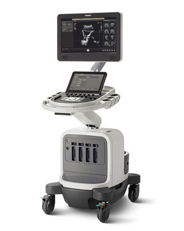

cleaning filter
Equipment: Philips - Affiniti 30
Wed Jan 04 2023Reply from jrreyes
jrreyes
If its telling you the filter cleaning is due then clean clean the filter located on the bottom. It pulls out from the side below the door for I/O connections. Then press the support button. Under the hardware tab there is a selection to reset the filter cleaning.
