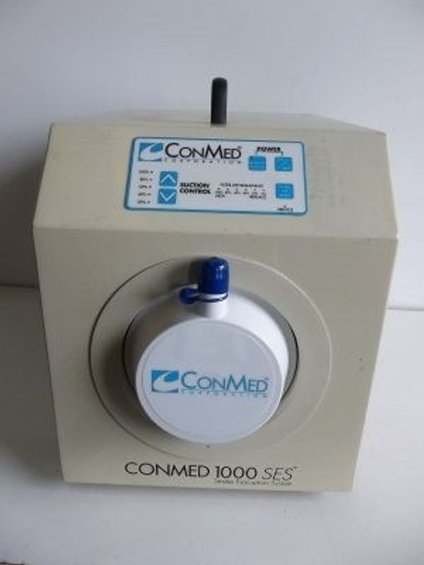

Does anyone have a service manual for this unit? We are trying to order replacement filters and need the part number.
   RE: Smoke Evacuation System Report Post
Wed Feb 01 2023Reply from T-Lobato
T-Lobato
I don't have the service manual, but I believe this is the part you're looking for. I pulled this from PartsSource.com
AER DEFENSE FILTERONE by CONMED
OEM #: 60-8084-001
TJ Lobato | MedWrench Guru
Thu Feb 02 2023Reply from Chris S
Chris S
I will upload the manual, but here is what is shows for filter part numbers:
• Filter, 7/8" Male Port, Case of 2 Cat. No. 60-6875-001
• Filter, Dual 7/8" or 1-1/4" Male Port, Case of 2 Cat. No. 60-6875-002
• Pre-Filter for Valleylab Airforce / Surgimedics Surgifresh Cat. No. 60-6842-001
