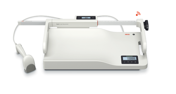

Is there anyone that can provide me with directions on calibrating a Seca 333i scale?
Each time I take a measurement I get a slightly different weight.
Please advise.

Calibrating the scale likely won't help if it keep changing. These scales typically have 4 load sensors and at least one is going off. We run into this every once in a while and calibration only helps when it's consistently wrong. Otherwise after cal it won't be consistently right.
