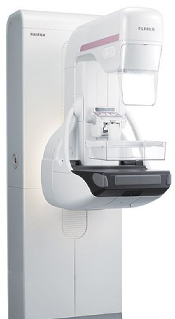

Fuji compression
Compression stuck all the way down. Shut machine off and brought it back up. Still won’t raise. Any suggestions?

Disassemble the blade support. Check the condition of the rollers, the belt, and the electric motor of the blade lifting drive.
