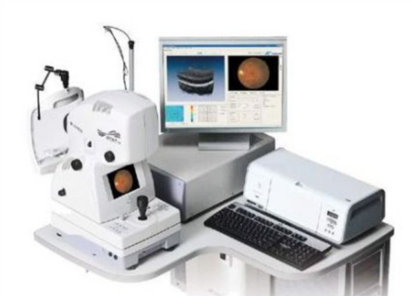

Dear all, recently I'm having with my 3D  OCT-2000 topcon displaying, " you may not get high sensitive image (2014). Proceed ? " followed by "camera error ( 0000000f) " when we try to capture an image. I would appreciate if anyone could possibly help.
Anteneh
Equipment: Topcon Medical Systems - 3D OCT-2000

Hello there,
I hope this message finds you well. I am reaching out regarding an issue we are experiencing with our 3D OCT-2000 device. Recently, we encountered an error message on the screen that reads:
"You may not get high-sensitive OCT image (2013)."
We are unsure about the cause of this error and would appreciate your assistance in diagnosing and resolving the problem. Could you kindly provide us with more information on what this error indicates and any potential troubleshooting steps we can take?
We would greatly appreciate your prompt response and guidance on how to address this issue. If you require any additional details or information from our end, please let me know.

Hi Anteneh,
I have worked with 3D OCT-2000 systems and may be able to help you troubleshoot this.
For Camera Error (0000000F), I would first check the camera-related cables and connections. In some cases, a damaged/disconnected camera cable can cause this error. The shutter/flash cable and its connections should also be checked, as a problem there can produce a similar camera error.
Regarding the high-sensitive image warning:
  • Error 2014 is often associated with reduced SLD output power. Cleaning the galvanometer mirrors and the optical/laser path can sometimes improve the optical power and resolve the problem.
  • Error 2013 may require optical alignment/service adjustments. Depending on the actual condition, Y-position adjustment and other alignment procedures according to the service manual may be necessary.
So I would recommend checking the camera/shutter connections first, and then servicing the optical path if the high-sensitivity error remains.
If you want, send me a photo of the error screen and the device serial number, and I can help you go through the troubleshooting step by step.
