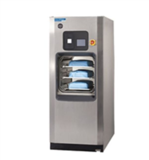

Amsco 400 series
On startup this 1 unit goes into depressurization, 20min. But stops around the 10 min mark. Customer says it sits there all day and they cant use it.
Is that a normal part of the cycle on the 400s? Chamber is empty, I can open the door and it makes no difference.
When the countdown stops, could it be a calibration issue?
What is thia depressurization, is it the sterilizer or the boiler, is it a feature that can be turned off?

Hey Chris,
I got the user manual off the Steris site HERE. I downloaded the french version then put the PDF through google translate. Section 9-12 and 9-13 talk about the depressurizing of the generator error. I'm guessing this unit has it's own steam generator and isn't plumbed to a steam supply? There is a pressure sensor for the steam generator and I'm sure a solenoid or two around it.
