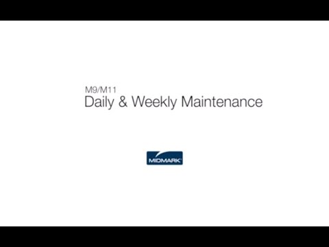

RE: SciCan - Statim G4This is an overview training guide on how to perform daily and weekly cleaning and maintenance on your Midmark and Ritter M9 and M11 UltraClave Automatic Sterilizers and M11D AutoClave Sterilizers.

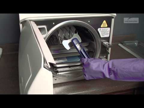

Remove trays and cassettes using the Midmark approved Tray/Cassette tool. Hold the tray level and slightly elevated to prevent it from shifting and becoming dislodged.
